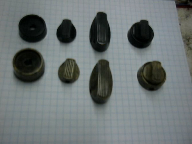

Do it yourself knobs.
Start with a set of good knobs. Or, take what's left of the old knobs and glue them together, fill in with lacquer putty and make look like they are supposed to.
Mount the knobs to a flat plate of plexiglass. Note: some of the knobs may require holes drilled in the plexiglass to hold shoulders, shaft extensions etc.. I use 1/2" (12mm) double stick tape to hold the knobs to the plexiglass bottom plate.
Stick a few #10 (4mm) hex nuts to the base plate to use as alignment keys in the mold.
Use 1/16" (1.6mm) styrene and make a form for the mold. Make it deeper than the exposed portion of the knobs.
Drill 5/16" (8mm) holes in the sides of the form to hold set-screw fillers made from brass rod.
In my case, I turned them to 0.065" (#36 drill) and 0.145" (#28 drill) to account for 6-32 set screws. After inserting the set screw shafts in to knobs through the side of the form, set them in place with some hot melt glue. Glue the corners of the form together with holt melt glue as well, and to the plexiglass base plate.
Give the knobs and inside of the mold a light coating with mold release. Mix the silicon elastomer and pour SLOWLY into the mold. Use a dental pick to chase the bubbles up to the surface of the pour. Note: I am using 2-part (90% silicon, 10% hardener) RTV silicon elastomer. It is available from Dow Corning.
Let cure overnight. The next morning, put in a warm oven, about 125 degrees F (50 C) and do a final cure for 20-30 minutes.
DO NOT REMOVE KNOBS FROM THE MOLD YET.
Remove the hex nuts from the mold.
Take the original frame (mold) apart by removing the hot melt glue. I find that a little bit of turpentine causes the hot melt glue to let go and remove eaisily.
Make a new mold frame out of styrene around the original mold. Treat the silicon surface with vasolene. (Use a small paint brush and coat all exposed surfaces of the first silicon mold that will have fresh silicon poured against it.
Use turned rods of the appropriate size for the shaft holes in the back of the knobs.
Give the mold interior and exposed knob backs a light coating of mold release.
Mix up another batch of silicon elastomer and pour slowly into the mold. Again, chase the bubbles up to the surface with a small curved dental pick.
Let set over night and again do a final cure of 20-30 minutes at 125 F (50 C).
You're almost ready to make knobs now.
Use a piece of small diameter brass tubing, .125" (3mm) with the INSIDE edge chamfered to use a drill to cut spru holes in the mold. This allows excess material to flow out of the mold in a predicatable fashion.
I cut my holes in the back side mold so that the excess casting material doesn't show on the front of the knobs.
Spray both mold pieces with a light coating of mold release.
Mix the casting material an pour some into the first mold almost full. Dribble a little bit into the mating mold to pre-coat the inner surfaces. Press the two mold halves together. Watch the excess material come up through the top spru holes. I am using 2-part (50%-50%) rigid casting urethane. 90-110 shore (hardness). In it's natural state, it's kind of a horrible yellow-cream color. You can use the dies specified by the manufacturer to make it any color you want. To make swirl patterns, mix two batches of urethane, say brown and cream, them swirl together prior to pouring in the mold.
Wait about 5 minutes and use a putty knife to move the excess casting material from the top of the spru holes.
Walk away and find something else to do for the next 20-30 minutes.
Gently seperate the two mold pieces. pay close attention to the part with the spru holes in it, as that requires a bit of dexterity to pry off of the part without damaging the mold.
Trim the excess material off of the new knobs.
By hand, run the required size drill bits into the set secrew holes to ensure they are the correct size, then use a tap to shread the smaller diameter.
And now, as if by magic, you have a fresh new duplicate set of knobs for that radio you've been wondering where to find knobs for.

- Original and newly cast knobs (87 KB)
- Front and back mold patterns (76 KB)
- Side view of molds (74 KB)
