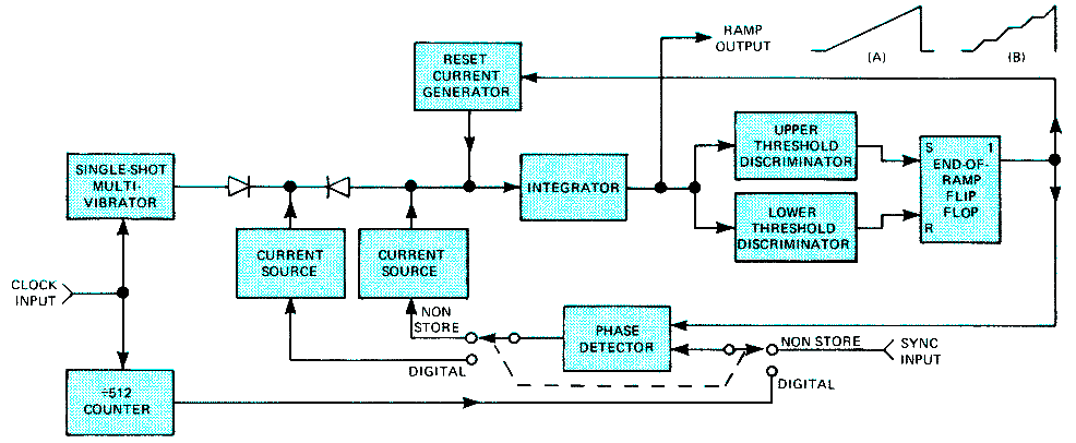

Ramp Generator. A block diagram of the Ramp Generator is shown in Fig. 3. Two of these circuits are used in the R7912: one for the vertical and one for the horizontal. In the NON STORE mode, the Integrator generates a highly linear ramp (waveform A) whose amplitude is precisely set by two stable discriminators which define the upper and lower end points of the ramp. This waveform is synchronized by the action of the Phase Detector which compares the end of the ramp with the sync pulses. If there is an error, it changes the timing, or charge current, of the integrator to insure proper timing.
Fig. 3. Ramp Generator.
In the DIGITAL mode, 5-MHz clock pulses are connected to a Single-Shot Multivibrator and to a / 512 Counter. Each time the Multivibrator fires, a small amount of current is injected into the Integrator, resulting in a step at its output. The voltage of the output step remains stationary during the Multivibrator's quiescent period. After a number of ramp and hold steps have been accomplished, the Upper Threshold Discriminator resets the End-Of-Ramp Flip Flop causing the integrator to reset. The circuit is then ready to produce a new staircase waveform. The output of the End-Of-Ramp Flip Flop and the / 512 Counter are compared by the Phase Detector. If these pulses do not occur simultaneously, a correction signal is generated by the Phase Detector and the charging current of the Integrator is suitably adjusted. In this fashion, the Phase Detector insures that precisely 512 steps are generated for each vertical or horizontal scan, resulting in a stable digitized waveform.
One of the features of this circuit is that the period of the staircase can he changed without affecting the accuracy of the staircase. This occurs in the operation of the R7912 when a point is addressed on the target where a waveform has been written. Normally, the staircase holds at each step for about 100 nanoseconds while the signal on the target lead is checked for a change in state since the previous sample. If there is no change, the staircase is advanced to the next step. However, when a change is detected, the staircase holds at this step for about 1.6 microseconds to allow time for the address of this data point to be transferred to the computer or stored in memory. As a result, each staircase may have a different duration since the number of these pauses for address transfer will vary depending on the nature of the waveform written on the target. In a conventional feedback-stabilized circuit, this would result in timing variation and an inaccurately digitized waveform. To prevent this, the clock input pulses are interrupted during the address communication time. Both the Single-Shot Multivibrator and the 512 Counter remain inactive until the clock resumes. Highly stable circuitry in the Integrator holds the step level very constant during the pause. The overall result is that when normal operation resumes, the outputs of the End-Of-Ramp Flip-Flop and the / 512 Counter have been delayed by the same amount of time. Therefore, no error signal is generated at the input of the Phase Detector and the ramp generator remains stable and phase locked even though the period of the staircase has changed.
Each of the vertical and horizontal steps has a BCD - coded address associated with it which is stored in the optional memory or transferred to a computer when valid waveform data is detected on the target. Both a vertical and a horizontal address is required to define a point on the target. Since the dot raster is a 512 by 512 matrix, there are over 250,000 addressable points on the target. The average waveform normally requires about 1500 points for complete definition. However, under some conditions such as dual-trace operation, two waveforms may he stored in memory simultaneously. To provide adequate storage, a 4000-word memory has been provided as an option for the R7912.
