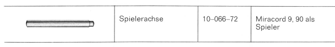

Hi,
Can anyone tell me the model number of the single-play spindle I need for the ELAC Miracord 90? Or other ELAC turntables that use the same spindle?
Thanks,
Mike
elac: ELAC Miracord 90 kurze Spindel short spindle
01.Jul.21 17:02
18 from 900
Mark Hippenstiel (D)
Articles: 1192
Count of Thanks: 3
Mark Hippenstiel
Hello Mike,
there are a number of spindles:
  • Spielerachse (normal operation), part no 10-066-72
  • Stapelachse (changer spindle), SA 72
  • Stapelachse (changer spindle for 45s), SA 382
All of those were used in models Miracord 90 and Miracord 9, no others (as per parts list/price list).
Given the apparent simplicity in comparison with other such part, it should be fairly easy to reproduce, I'd wager.
HTH,
Mark
