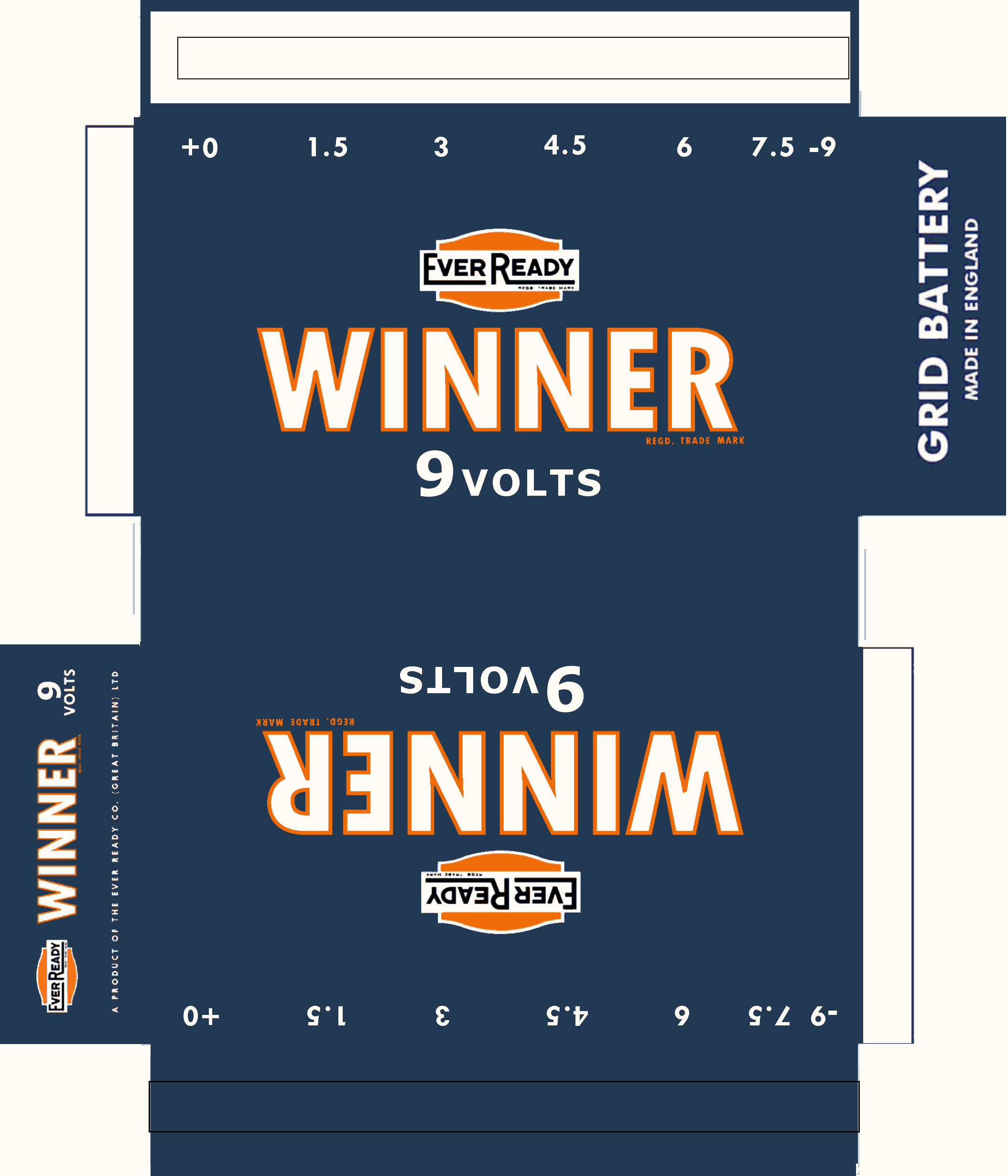

Printing the "cover"
The cover image is 179 x 208 mm (7" x 8.2") and should be printed 100% at 300dpi. Print on good quality paper (80gms or 90gms), not card, as any card for a printer is too thin. Then spray mount or use Pritt/UHU glue stick on thick card from a folder or cereal packet. Only then cut out.

Don't leave to dry, but cut and fold at once so that paper stretches over card at corners.
Note that you can crease on the rear with a ball point pen and ruler. Ensure tabs/flaps have channel cut to allow for thickness of card when folded. The plain inner tabs are folded closer in than the creases for outer corners by card thickness.
In use the real packs had a tear off strip to expose all the top sockets. Early models filled with pitch / tar insulation. The height of the pack is basically the socket depth and R12 ( "B" cell) height. So cut a slot on the top.
