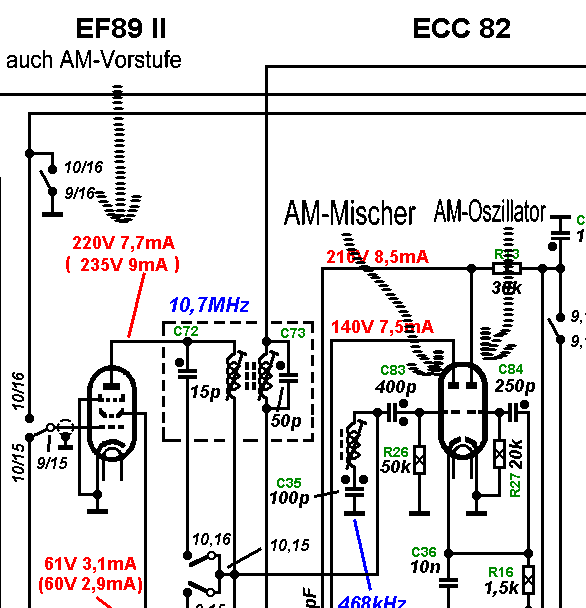

Unfortunately Herr Bradtmöller had some problems with directly posting an answer.  Here is his answer:
Hello Herr Knoll,
...  The Grunding 5040, in my opinion, really only has one tuned input circuit for short wave.  In contrast, for medium wave there are two.  However, the whole thing  has been referred to as an input band filter circuit.
Medium wave and long wave:  1-1-P-0-M
Short wave:  1-P-0-M
Example 1: (11P0M) means means two resonant circuits or bandpass filters before the RF stage, with aperiodic coupling to the mixer stage.
Abbreviations:  1 = resonant circuit, P = preamplifier, M = mixer, F = amplifier only for the ferrite antenna, 0 = aperiodic (nonresonant or untuned).
Source:  http://www.oldradioworld.de/rfpre.htm (link has both English and German information in detail about RF and mixer stages of various configurations using the above terminology)
The circuit diagram at that site is different with respect to the tube placement; in principle, however, the function of the stage is as follows:
Translation for above diagram:  "auch AM-Vorstufe" = also serves as AM RF stage;  "AM Mischer" = AM mixer; "AM Oszillator" = AM oscillator.
Am I seeing that correctly?
With regard to answering the questions in the circuitry analysis thread, that's as far as I can go.
Just a few of my thoughts:
The bandwidth of the AM section is essentially set by the IF amplifier (9 kHz).
Since the input circuits are tunable, according to Adam Riese, the Q can't be extremely high, because a pronounced resonance at a single frequency is not desirable here.  Strictly speaking, a resonant circuit, consisting of an inductance and a capacitance, has just one resonant frequency.  If this is made variable, either with a variable inductance or variable capacitor, the Q, and therefore the bandwidth, varies with frequency.
Therefore, the input circuit has to have a wider bandwidth than the IF transfer curve.  During alignment, the goal is uniform response, or good tracking, rather than peaking the resonance of the input circuit.
Do I have it wrong?
Using this approach, I can't give an exact answer to the question about the bandwidth of the input filter, if that's what we want to call it.
Best regards,
K.-H. B.
