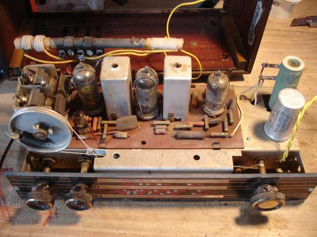

hello Maitiu,
Thanks very much for the reply.
The rear wall don't have the tube line up, but the tubes are:
UCH81; UBF89; UCL83.
I think that radio comes from Great Britain, because he have a "licence plate" of Great Britain.

hello carlos ,this is very very interesting indeed , oviously this set was made here in dundrum for export to the uk , and that plate would have to be fitted before it could be sold in britain, the gaelige name for ireland is eire , deanta san eireann, means made in ireland , i will research this set in the coming weeks for you . i notice the logo of the irish harp on the grill , even though we have the euro coins here now we have retained an identical harp as that one on the reverse side of our coins ,
i notice the radio is an ac/dc set with a live  chasis , so dont touch any part of it when live , i presume you must understand that , , ill try and store your pictures as ill need to show it to the irish members of the society , regards maitiu standun ,

The radio already works
23.Apr.08 23:26
Carlos Alves (P)
Articles: 105
Count of Thanks: 14
Hello radio friends,
The radio already works.
I change only the paper condensers, and  works well.
