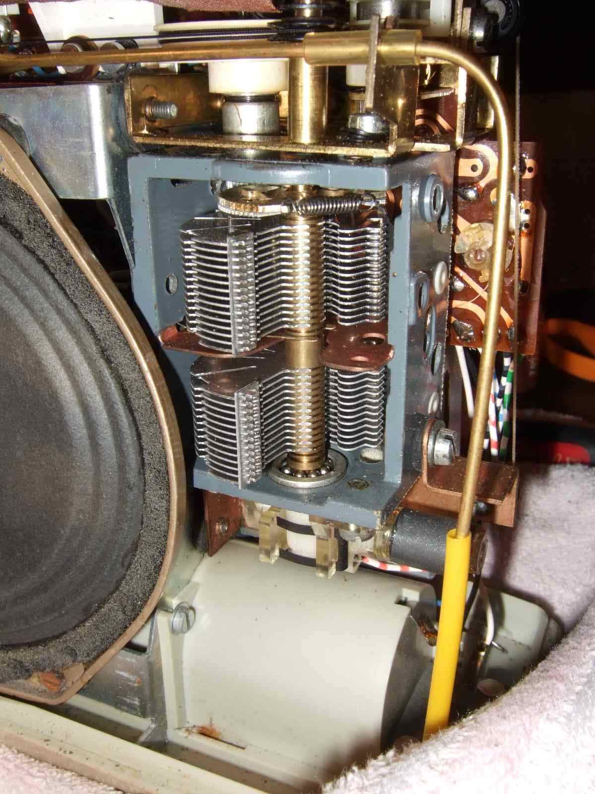

1. What lubricant should I use to lubricate the tuning condenser? It appears to turn freely and is not stuck. But I think that it would turn a little more easily if it were lubricated. Can I use ordinary contact cleaner or is there a better lubricant to use? I want something that sprays or brushes-on because I do not want to remove the condenser from the radio.

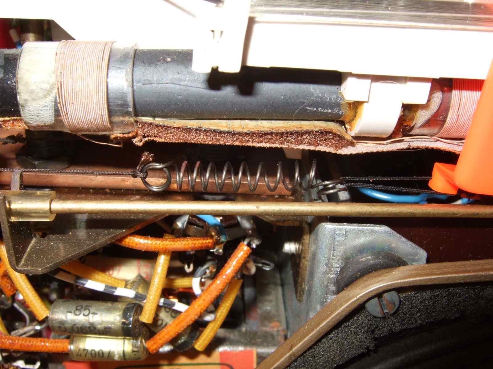

2. The AM dial cord spring is stretched out, probably due to a prevous repair. Where can I obtain a new replacement spring at reasonable cost? Is there a good online source?
If available, I would like to buy an assortment of many small springs (of various different sizes and tensions) so that I would always have them ready for use. Is there an online source that sells this?

i would not suggest you to use contact cleaner alone, it will soften the moving for a little time, but after some of the ingredients are evaporated, the remaining contents will bake harder together as before, in the worst case, the variable capacitor will get stucked. You can use contact cleaner to soften the old lubrication but you must (!) remove thoroughly this solution with an additional cleaner, something alcohol based come in handy here and then relube carefully with a light oil.
To get an assortment of springs, e-rings, screws and so on, i would suggest you to get an old photocopier for low money and disassemble it. You will be astonished about the amount of useful mechanical parts you can rip out of it ;)
