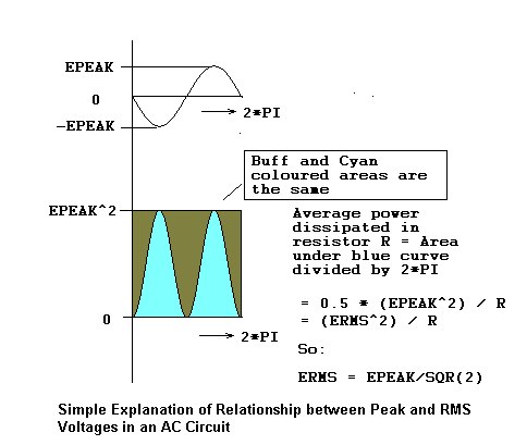

Recalling the Basics
An AC voltage of 230 volts is a varying voltage that changes from zero to approximately 325 volts then down to zero then to -325 volts and back to zero again 50 times per second. Thus, the difference between maximum negative and maximum positive voltage is about 750 volts (which is what it feels like if you get yourself across it.) This can be expressed mathematically as:
E0 = EPEAK*SIN(2*PI*F*T) ;where
E0 = Instantaneous AC voltage
EPEAK = The peak output voltage measured from zero to the maximum positive voltage
F = Frequency in Hz (50 in South Africa, 60 in the US)
T = Time in seconds
In a DC circuit, the power dissipated in a resistance R with a voltage V applied to it is :
(V^2) / R.
In an AC circuit, we would like to have a similar simple relationship, so that when we calculate the power drawn by an electric kettle with an element resistance of R, we can express it in the form:
((k*EPEAK)^2) / R; where k is a constant.
Since E0 varies, we must take an average for the value of E0^2 over a full period of the AC waveform. We do this by calculating the area under the curve for E0^2, as shown in the following diagram:
(Beware!  - Squaring a sawtooth waveform, for example, does not result in equal cyan and buff areas, so the RMS value will have a different relationship to the peak. )

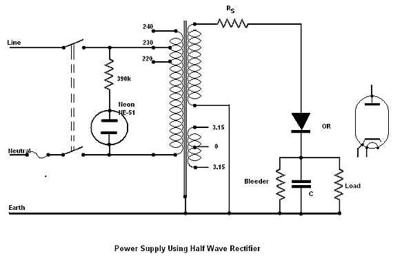

Power Supply using Half Wave Rectifier Circuit
In what follows, it is assumed that the smoothing capacitor C will have a “large” value. The design proceeds by selecting a suitable transformer.
Suppose we need a power supply for the two valve superhet.
Supply voltage = 200 Volts
Supply Current = 20mA
Transformer required will be 200 * 20 / 1000 = 4 Watts
Filament 6.3 Volts * 0.6 A total = 3.78 Watts
Total 7.78 Watts
Allow a factor of safety approx 1.5 and use a 12 Watt transformer.
Now select a rectifier – I'm going to use a 1N4007, basically because they are extremely inexpensive and will handle 1.0 Amp, with a peak reverse voltage of 1000 Volts. Max surge current for this type is 30 Amps, which would give a value for Rs = 141/30 = 4 Ohms. The chances are that the transformer secondary resistance plus the effective primary resistance is way above this value, but its advisable to measure them all the same. You will have to multiply the primary resistance by (NS^2/NP^2), where NS/NP is the turns ratio of primary to secondary, or VS/VP – the voltage ratio.
The remaining component is the capacitor. For a radio receiver, we might want a ripple of about 0.5 volts. Note that this is 0.5 volts peak-to-peak. To get the RMS value of the ripple, we divide by 2.828 (or 2/SQR(2.0) ), this gives us 0.176. The % ripple is then (0.176/200)*100 or .08%. (Not everyone considers the % ripple this way, and I'm not sure whether this is correct, or whether simply taking 0.5 / 200 = .25% is the correct answer. For the purist, none of the above are correct, since the ripple approximates to a sawtooth waveform.)Half Wave Ripple
Then C = ((10^6) * .02 ) / (50 * 0.5) = 800.0uF
I think we can agree that this is not a particularly happy answer and although readily available, this capacitor will cost around US$ 20.00.
What if we had decided to use an EZ81 (Strapping the anodes together) ? Well – if we look at the data sheet, we see that the maximum value of capacitor we can use is 50uF per anode, and that we also have to use an Rs of 150 Ohms per anode. This means that our ripple voltage will be around 4 volts peak-to-peak and we will lose 20 * 150 /1000 = 2.15 volts. The power rating for the resistor Rs would be (2.15 ^ 2) / 150 – very small. To arrive at the transformer secondary voltage, we need to add up all the voltage drops on the way to the load. These might be:
Diode drop (1N4007) = 0.7 volts
Transformer Internal resistance = 30Ohms *.02 + (230 / 200)^2 * 40 Ohms *.02 = 1.66 Volts
Ripple voltage = 0.25 volts (0.5 pk-pk)
Total = 2.6 Volts
So, we need 202.6 peak volts from the transformer = 143.3 volts RMS.
If you're using the EZ81, then there will be voltage drops in the series resistors (if used) and estimate the voltage drop for a load of  20 mA, using the valve characteristic curves. By eying the characteristic curve data, it looks like about 15 volts, for the two anodes strapped together.
EZ81 Drop  = 15 volts
Transformer Internal Resistance = 1.66 Volts
Ripple = 2.15 volts
Remainder of valve series resistance = 75 Ohms but Transformer Internal resistance = 82.9 Ohms
Total voltage, peak = 218.8
Transformer voltage = 154.7

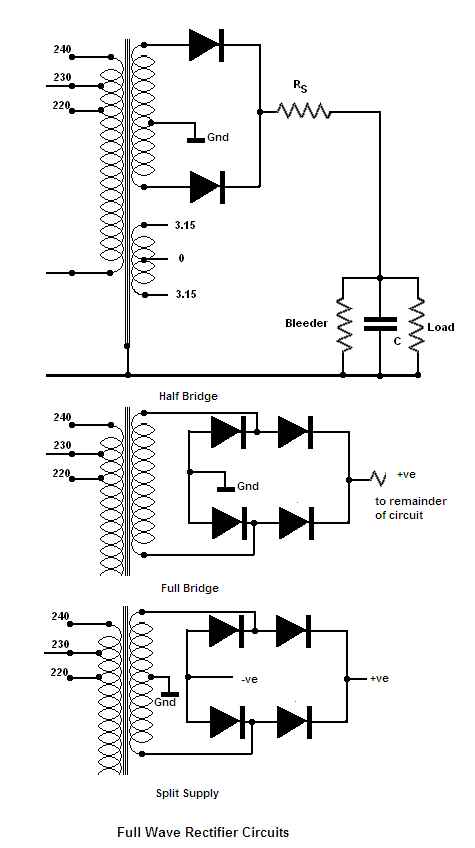

Full Wave Rectifier Circuits
The half-wave rectifier circuit has little to recommend it now that rectifier diodes are so inexpensive. For one thing, the transformer only really does any work during the half cycle the diode conducts and it requires double the size of smoothing capacitor for the same ripple (as we shall see). Any savings made by cutting out 3 diodes will be totally annihilated by the additional costs of a capacitor.
The three circuits given all have their valve counterparts, but the one most commonly used is the half-bridge with the centre tapped transformer. For low voltage op-amp power supplies, transformers are readily available with two secondary windings. These may be connected in the correct phase so they can be used with the 3rd circuit.
Calculations can proceed as before by selecting a suitable transformer (or winding one), allowing for the voltage drop across Rs and the diode voltage drops. To be strictly accurate, half the ripple voltage should also be deducted, particularly if it is large. You might have to make this calculation quite carefully if you are planning on following your unregulated supply with a 3-terminal regulator. In this case it would be wise to take into account variations of 10% in the mains supply – because you don't want the regulator to “drop out”. (Where I live, the mains voltage can vary between 310 volts and 150 volts, which is rather harrowing.)
Suppose we want to design a 15 volt 500mA power supply using a 7815 three terminal regulator.
Then we need at least 18 volts to prevent drop out. If the ripple is 1 volt, then we need to add this.
There will be a further 0.7 volts drop in the diodes and a drop caused by resistance of the transformer windings of, say, 30 Ohms * (20^2)/(230^2) = 0.24 + 1 Ohm in the secondary, giving a voltage drop of .6 Volts. (Making a guess that the turns ratio is 20/230)
Total voltage required is thus (15 + 3 + 1 + .7 +.6 )*1.1 = 22.3volts.
This could be provided by a transformer with a 22.3*.707 = 16.8 volt secondary. The nearest transformer available off-the-shelf has a 17.5 volt secondary.
Now we calculate the value of the capacitor required to give a 1 volt ripple, remembering the ripple frequency is now 2*50Hz:
C = ((10^6) * .5) / (2*50* 1.0) = 5000uF (The nearest preferred value is 4700uF, but it might be better to play safe and use a 6800uF capacitor – remember the tolerance!). I would make it at least a 35 Volt Working.

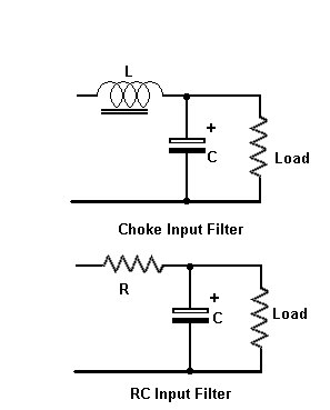

Adding an output filter
The theoretical values calculated for the smoothing capacitors may have come as a shock. This will be particularly true for people used to working with old radios with 5Y3 power supplies having small capacitors of 8uF or so.Power Supply Filters
What always used to be done, was to add a choke in series with the output and a capacitor to ground:
Typically, the choke might have had a value of 10H and a resistance of  330 Ohms. The capacitor C would have had a value of anything from 8 to 270uF or more. The combination of the choke impedance and the capacitor acts as a voltage divider, on the ripple voltage so the ripple becomes much less.
Taking our EZ81 half-bridge with its 4 volts peak to peak ripple and a capacitor C of 100uF, then the choke impedance at 50 Hz (Its a half-wave circuit) would be:
 2*PI*F*L  = 2*3.14*50*10 = 3140 Ohms. In addition, it has a resistance of 330 Ohms.
The capacitive reactance would be:
10^6/2*PI*F*C = (10^6)/(2*3.14*50*100)  = 32 (Much, much smaller than the load resistance, which can be ignored)
So the ripple becomes 4 * 32 /(3140 – 32 ) = 0.04 Volts
This is all very interesting, but unless you are making a hi-fi valve amp, you probably won't want to use a choke and in any case, they are heavy and not readily available. Note that in theory it is possible to get L and C to resonate.
Toward the end of the valve era, most sets had done away with the choke. Even published Hi-Fi circuits just had a simple resistor-capacitor input filter. Usually, there would be a connection from the input capacitor to the final output stage, followed by an input filter feeding the remainder of the circuit – see for example the Mullard 3-3 amplifier, or Brimar VA10.
Suppose we simply were to use a 3300 Ohm 2Watt resistor and 100uF capacitor, then the ripple would be:
4 * 32 /(3300+32) = .038 Volts
BUT we would lose 66 volts across the 3300 Ohm resistor. Actually, a more sensible value for the resistor might be 330 Ohms, then we would lose only 6.6 volts.
