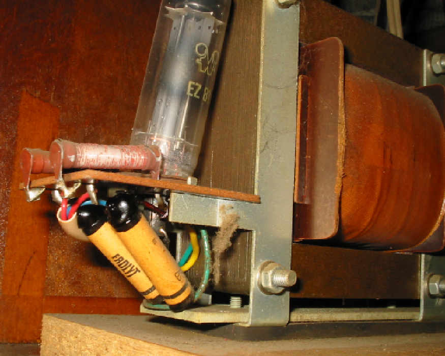

01.Mar.09 15:40
Emilio Ciardiello (I)
Articles: 527
Count of Thanks: 15
Emilio Ciardiello
Hi all,
first I wish to underline that many of the old equipment, no matter if industrial or house appliances were unsafe at all. I remember transformerless radios or record players, with cabinets and knobs made of vile plastic, generally crushed after a short use. When I restored ANIE qualified Italian radios for some friends that want to use them, I first added a good insulation transformer inside the cabinet.  And how many equipment I have seen, that used flammable parts or, even better, asbestos inside to prevent fire! More, I also remember to have replaced two ground-fault safety interrupters not working at all, one with melted contacts!
The planning of the job to do to restore any old equipment may be subjective and depends upon a careful evaluation of the actual status. Nevertheless, creating a low-impedance path between the chassis and the earth, to prevent shocks in case of poor insulation, is one objective safety rule.
From the pics loaded by Keith, I see two tar-sealed paper capacitors. Of course, I cannot know if they are on the primary side, but tar is swollen and partially melted: these capacitors should be replaced. Well, how many people really know what kind of dielectric can be specified for a RFI filter capacitor from the mains to the chassis? How many people really know the availability and the use of class X or class Y capacitors? I suggested the use of a IEC filter, just because its manufacturers certainly had the proper experience to have made a safe, foolproof component. In addition, in a stereo amplifier noise is kept lower by a ground connection, and a good RFI filtering helps to reduce clicks due to i.e. neon lamps.
About the second item, the grounding of other auxiliary equipment, the answer is a bit more complex. The ground wires should be connected together, but loops must be avoided. This means that if a common connection already exists through the power cable no additional connections should be made between the metallic chassis. Or, if you are using a 5-wire connection cable, with an earth wire, you should not use 3-wires power cable on the second unit. In other words, you should avoid any loop that may be coupled with external magnetic fields, says transformers or even mains wires, otherwise loud hum may result.
Regards, Emilio
