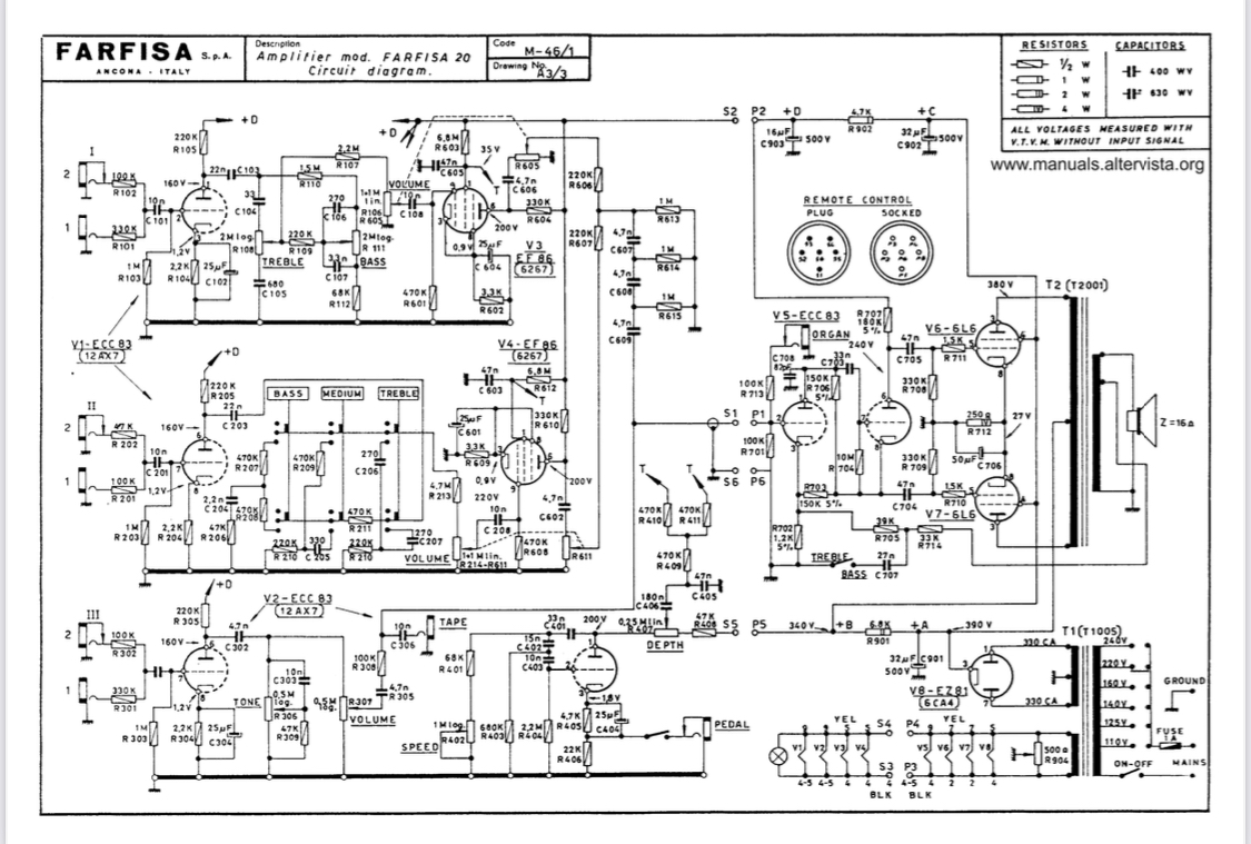

Hi Henning,
Thanks for your kind reply.
Here is the wiring diagram (attached), what do you think?
Alessio

Measure current through the output tubes by measuring the voltage drop across their cathode resistor R712. First, make sure that it has the correct value and that C706 isnt shorted.
Regarding the output transformer, i agree with mr. Oelkers that it is probably already bad and will need to be replaced or rewound. As this amplifier is lacking RC networks or varistors across the transformer's primary, there's always a risk that transients, for example due to a sudden disconnection of the speaker while the amplifier is delivering high output or due to a short circuit or flashover in one of the output tubes, could cause a flashover and permanent damage to the transformer.

Hi Torbjörn,
Thanks for your responses. I have verified C706, is ok.
Regarding the voltage drop across their cathode resistor R712, do I have to put the tester in the point indicated in the attached photo with the amp on? It's must measure 27v, right?
