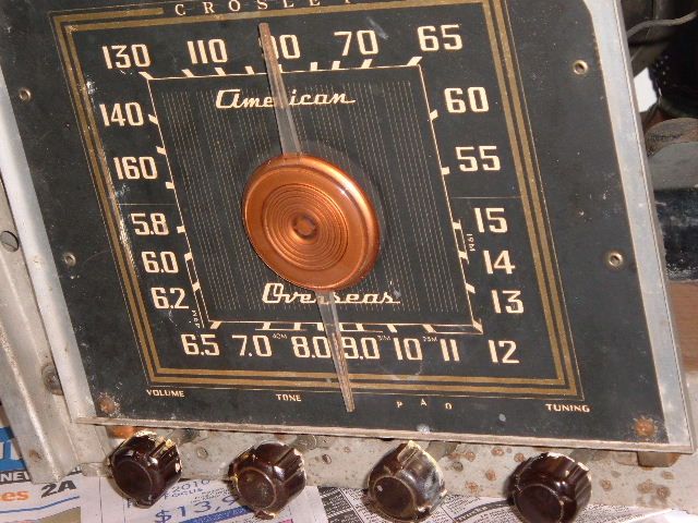

Dear Dave
Can you please upload some pictures of your model?
If it is a part now then it would be good to start with the inner part of the chassis - specially if it is still untouched!

Dear Ernst and Al,
I've been referring to this as a CA, however it must have been either a CP or CQ depending upon which record changer was used.  The only components I have are what is pictured, (no phono).  I do appreciate all the advise and guidance.  I also want to learn this the proper way instead of just guessing at what will correct it.  I'm using this chassis as my first real set, in order to learn the proper way to diagnose.  I do want to hear it play, but most importantly want to know what was wrong and how to determine that.
I've uploaded pictures for now and will follow the recent direction as soon as possible and let you all know what I find.
