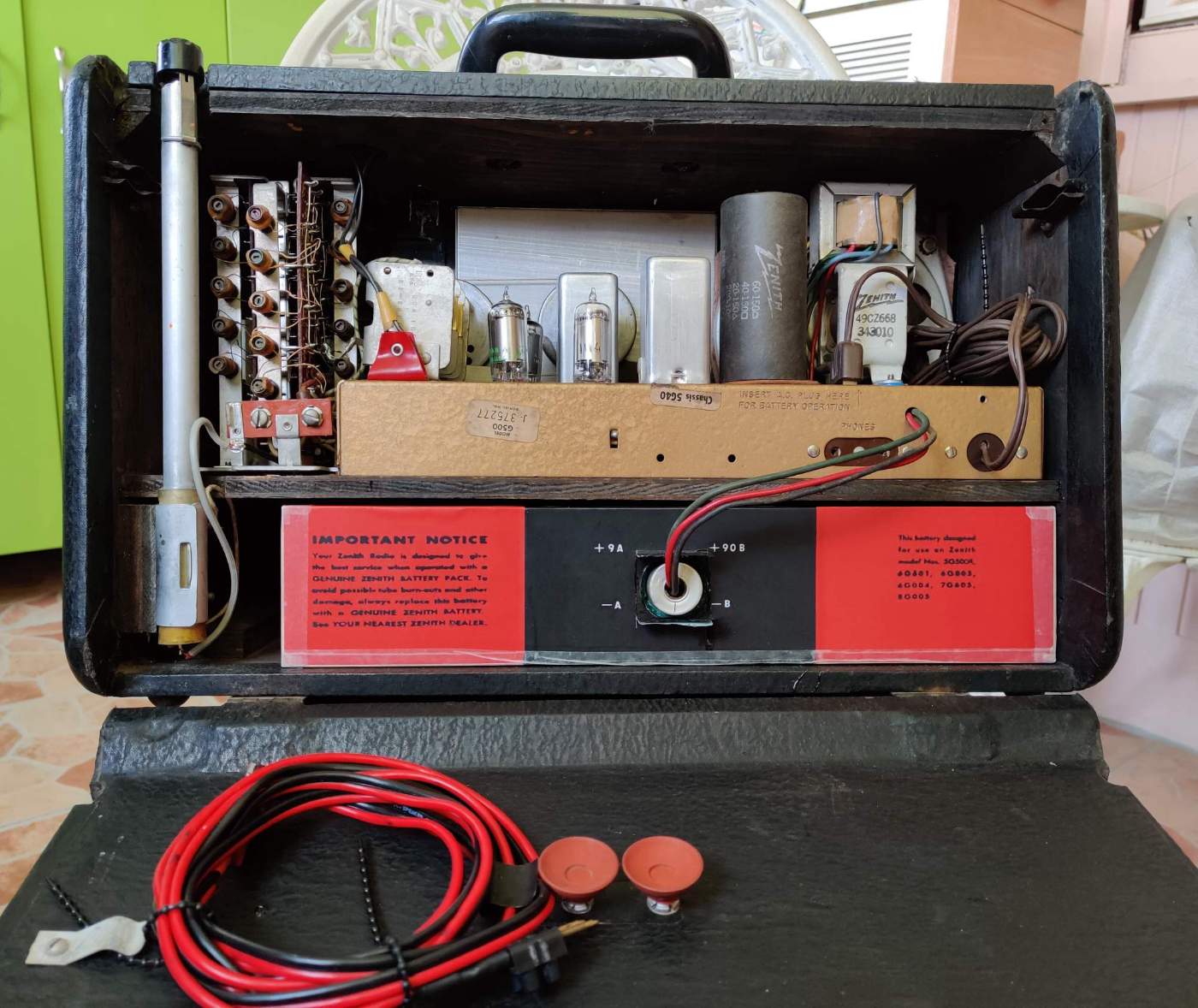

Yes you have the docking space! Thanks to Michael, too.
I'll show you in the photo.
The other comment based on my rehearsals, I followed the sketch of a colleague Heigl, unfortunately contains the error. The 100 Ohm resistor on the battery connector started to burn, I turned off the power in time. An interesting result of this problem was that the original volume of the hitherto quiet radio had returned.
I show the corrected drawing as well as the connector I made (Plastic bottle cap and 4 RCA connectors).
I hope I can help the new G500 owners.
It is interesting that instead of 90 V, 75 V is enough, and then I convert it to 90 V with such an extra block. There are 3 in it now.

Only the very fresh batteries are 90V (actually a little more) and 9V. 70V to 85V is fine for HT and 7.5V to 8.2V for LT. The original "end point" would have been about 55V to 60V for HT and about 6V for LT depending on the tube condition. The gain and max volume tails off gradually with HT dropping, but the Local Oscillator tube (valve) stops quite suddenly between 1.15V and 0.9V depending on the tube condition and the band. The higher  frequencies fail first as tube or battery ages.
I made a replica pack with 6 x Alkaline D cells, 60 x Alkaline AA cells and important are fuses! Especially on the HT as the AA alkaline cells are rather lower resistance than the layer cells or even the older Zinc B cells used in non-layer HT supplies.
