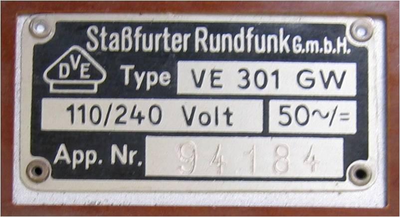

Dear Radio Friends,
  I am in need of a good quality photo of a data plate from the back of a VE 301 GW from the manufacturer: Radio-Funk-Werks.GmbH (RFW).   I am attempting to recreate the black graphic and text on top of the now blank (aside from the stamped serial number) data plate which is riveted to the back of the chassis.  I found several blurry photos here from later models/versions of Gemeinschaftserzeugnisse Vorkrieg produced radios bearing the RFW tag, but I am not convinced these look exactly like the ones found of the VE 301 GW.  Any help is greatly appreciated!
MfG,
Bob

This is the tag for which I am searching for a photo of, but from the Radio-Funk-Werks.GmbH (RFW).
 (this photo is from anonymous 759 Collector)
