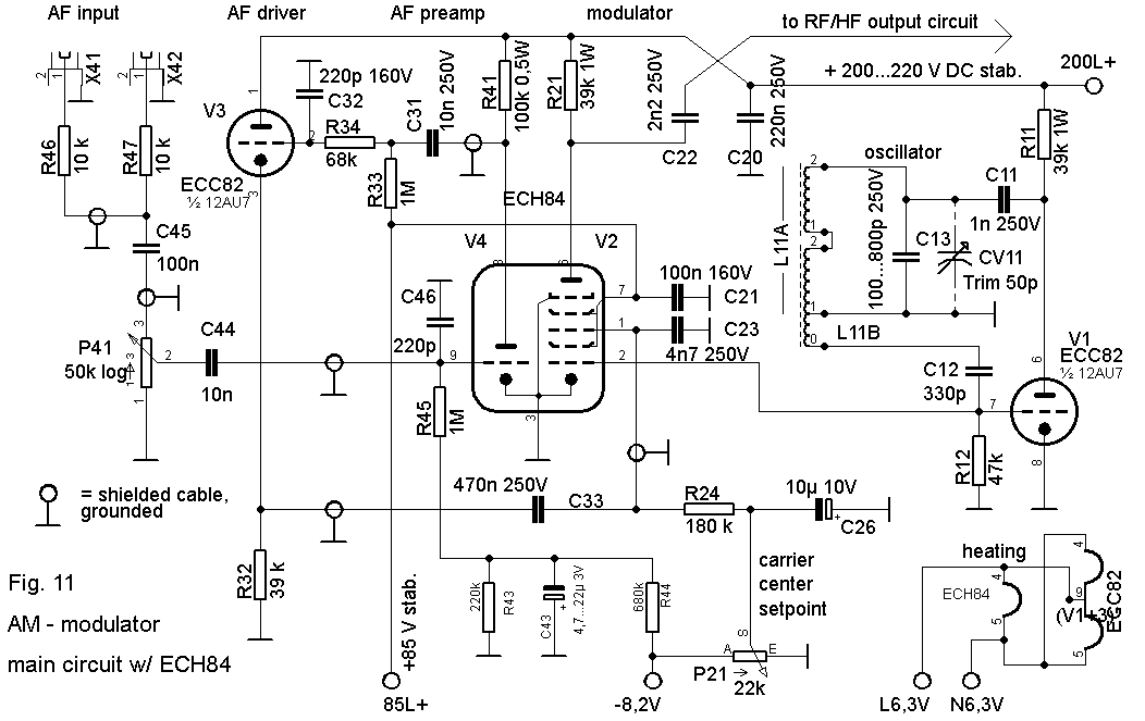

Hello Joe and fellow radio enthusiasts,
from one point of view this Granco ARC60 AM modulator is an interesting circuit.
But I have some serious doubts, whether this modulator circuit may meet more than very modest requirements.
To achieve a modulation degree of more then a few %, a tube with AGC characteristics may not be used.
However, using heptodes with sharp-cutoff characteristics will allow modulation degrees up to 100 %.
Single-heptodes as the 6BY6; 1680; 2032; 5915 = EH900S = EH960; E91H = 6687; and some further equivalents of them will give good results at screen voltages of 75 to 85 volts and plate voltages of 75 to 250 volts. I never tested them on lower voltages as shown in the circuit above.
The European triode-heptodes ECH84, ECH200 and PCH200 are also well qualified. Their triode section may be used as audio preamp or oscillator.
The next issue of this Granco modulator is its local oscillator which is operated between grid 1 and cathode of the modulator tube, in the same way as in a normal receiver front end, using pentagrid converter tubes like 6SA7 or 6BE6.
Some years ago I've made an experimental setup, operating a 6BY6 or 1680 this way.
By increasing the (amplitude) modulation as usual, a considerable degree of frequency modulation occurred. At higher modulation levels the frequency modulation grew such as high as to make it impossible to tune-in the signal on a normal bandwidth AM receiver without severe distortion !
As a consequence, a heptode modulator requires an external oscillator to obtain a constant frequency.
If properly designed, Heptode modulators are very well suited as very-low-power transmitters for home-service purposes.
To achieve close-to-broadcast quality one should pay attention to some requirements:
  • a heptode with sharp-cutoff characteristics on both grid 1 and grid 3;
  • an external oscillator to generate the carrier frequency,
  • the carrier frequency signal should be fed to the heptode grid 1, while
  • the audio signal should be fed to grid 3;
  • the audio input at grid 3 must be kept free from any RF signals, strayed-in by the oscillator circuit or by the plate output.
 further recommendations:
  • a buffer stage between oscillator and heptode grid 1;
  • a PLL or X-tal controlled oscillator;
  • a low-impedance driver stage (e.g. cathode follower) at grid 3 audio input, combined with a RF/HF suppressor.
Best Regards, Jacob

My AM modulator career
23.Oct.09 10:38
Articles: 1786
Count of Thanks: 32
Hello Joe and all fellow radio enthusiasts,
I started experimentations using multiple grid tubes as AM modulators already in my youth, as described in post #16 in this thread, first I used the octode AK2, soon followed by the RENS1234 (E449).
As I realised that a considerable audio distortion was caused by the AGC characteristics of these tubes, I looked about a tube with sharp-cutoff characteristics on both control grids and found the 6BY6
The audio quality by using the 6BY6 was much better than before, but still was not fully satisfying. Speech transmission was OK, but music appeared to be increasingly blurred, the more tones were played simultaneously.
This caused me in the mid of the 1990s to do a lot of investigations in order to improve the sound quality of my heptode AM modulator. I tried negative feedback without success.
By one of these attempts I used a penthode as audio driver instead of a triode as before, with the result of a noticeable increasing of this blurring effect !
Very soon I realised this can only be caused by the higher internal resistance of the penthode compared to the triode. The conclusion was, using a driver with low impedance will solve the problem !

 The circuit shown in Fig. 12 is the result of these investigations.
V2 is the sharp-cutoff heptode 6BY6 or a similar type, as modulator tube. V1 is one section of a 12AU7 / ECC82 as oscillator triode. The tuned circuit L11 and CV11 (+ C13) defines the carrier frequency.
V3 is the other section of the 12AU7, acting as low-impedance cathode follower AF driver to g3 of the 6BY6. Capacitor C23 suppresses RF in the g3 circuit, there are also C46 and C32 to keep the AF line clean from RF dirt. V4 is the AF preamp, in this case a 6AK5 in triode connection.
Operating B+ voltage is about stabilized 200 volts, while the heptode screen grids g2 + g4 are operated at 85 volts, stabilized by a 85A2 / 0G3.
As I realised, most datasheets suggesting 75 V as screen voltage for sharp-cutoff heptodes such as 5915, 6687, E91H and EH900S, I will also prefer 75 V as screen voltage in future projects, probably stabilized by a 75C1 or a 0A3.

The triode-heptode solution
Back to normal:
The use of the sharp-cutoff triode-heptode ECH84, which is easy to obtain in Europe, facilitates the AM modulator circuit and limits the tube number to 2.
The amplification factor of the ECH84 triode section has µ = 50, which makes it best suited as AF preamp V4.
The ECH84 heptode section V2 works in the same way as the 6BY6 shown in Fig. 12, as well as both sections of the 12AU7 / ECC82 working as oscillator triode V1 and AF driver V3.
