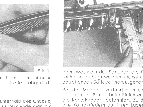

I need help to repair a  Mondello ST.
The UKW/FM contact botton doesn't work at all. The nonfunction seems to be a contact defaut.
I've tried to repair it, but I couldn't read the schematic instructions text in Rmorg archive sheets because it is written in German language.
The Google translater was not usefull to me, because it is not  technical and some terms are not translated meaning  this proposal.
Do You help me to understand, how do I do, to pull out the FM's contacts blade?
Chassis and dial glass is already out. Now I've to locate a spring to take it away. Am I right?
Does this move release the blade?
Well. I can't understand the text in German at all. Forgive me but give me some help, please.

Hello Mario.
on this Modell RTV350 you can find pictures for repair these Levers.
RTV350 Ch= CS350; Grundig Radio- (ID = 78262) Radio

Once again I got your kind help.
Thank You very much for your prompt reply.
Now, safely, the blade is out.

Hello Mario.
Work at reinserting the slide very carefully.
The contact -Springs are very sensitive to bend.
