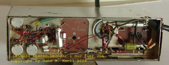

GRUNDIG Stereo-Decoder 1 for USA only
28.May.08 11:05
Articles: 2120
Count of Thanks: 55
Hello Friends of GRUNDIG.
Attached three Pictures from the orign. GRUNDIG Laboratorys Sample: DECODER 1
only for the US Market in 1961 to 62
here the output-terminals
