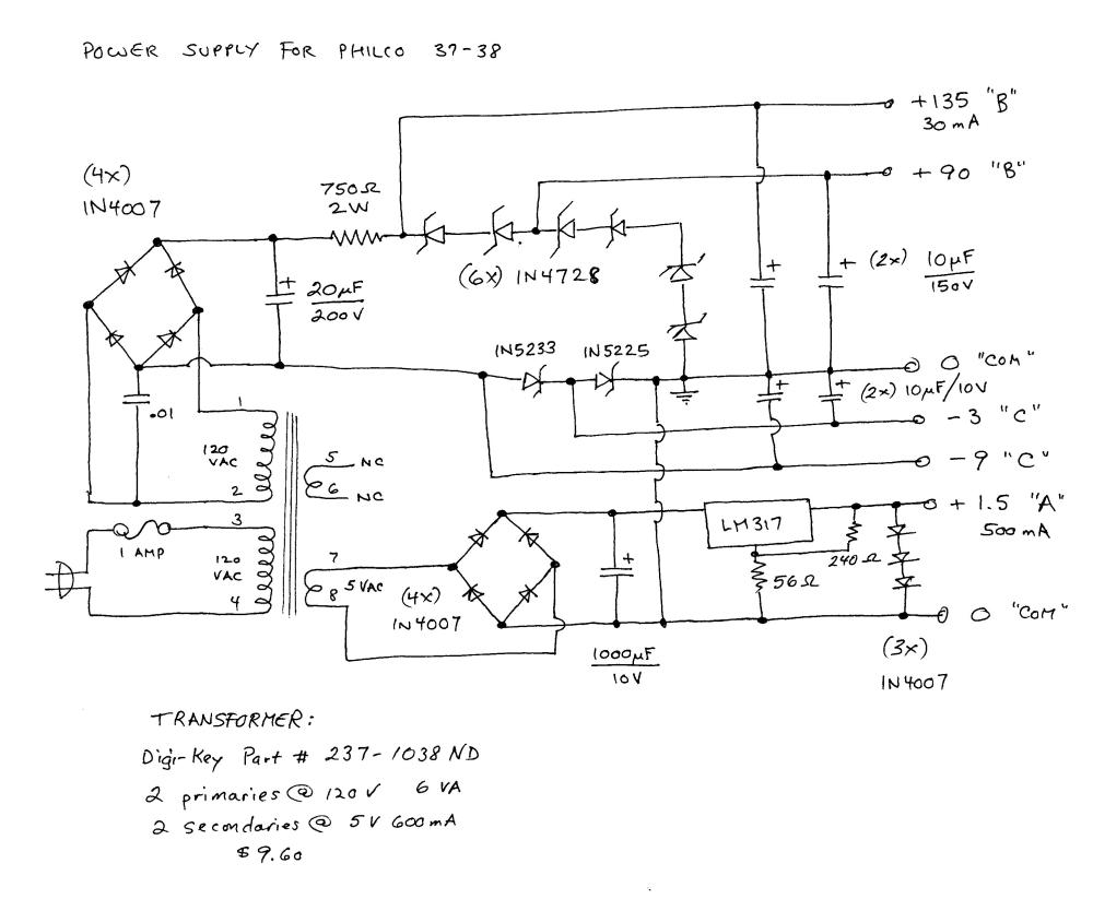

There are many different ways to design power supplies.  Here's an example (see attachment) of one I did for a Philco model 37-38, which would require only minor modification to work with this DKE.  This general design can be modified to cover a range of different battery radios.
Right now, the power supply is designed for -3 V and -9 V negative bias supplies.  To convert it to a single -6 V negative bias supply, simply remove the 3 V zener (1N5225) and the 10 uF capacitor across it, and connect the 6 V zener (1N5233) to ground directly.  Then the -9 V output terminal will become a -6 V terminal.
You don't need the +135 V output for the DKE, but many other battery radios use that voltage.  On the other hand, sometimes additional lower voltages like +67 V, +45 V, and +22 V are needed.  These voltages are in fact available with this supply by connecting to various points along the chain of 1N4748 zener diodes.  Add a filter capacitor to each tap which is used, just as you see here on the +135 and +90 taps her
Overall, this power supply is a little overdesigned for the DKE, and I would increase the size of the 750 ohm resistor until just before the +90 V terminal falls below 90 V with the DKE running off the supply.  Everything will run a bit cooler if you do that.
To convert the filament supply from 1.5 V to 2.0 V, replace the 56 ohm resistor with a 150 ohm resistor.  I would add a fourth 1N4007 protection diode at the "A" output when using at 2.0 V.  This is a "crowbar" protection circuit to prevent burning out the tube filaments in the antique radio in case the LM317 regulator malfunctions.
Here's a link to a nice LM317 output voltage calculator anyone can use to set the voltage of this regulator to a particular target.
Best regards,
Tom
P.S:  Please use the second attachment, showing 1N4748 zener diodes, not the first (which I can't delete).

Thanks for the power supply schematic.  The LM317 is indeed quite a useful little device.  In fact I just used on last week to connect a 3.3 volt Ethernet board to my 5 volt Basic Stamp.  Rather than add a second power supply, I just used a n LM317 to drop the 5 volts to 3.3.  Works great.
