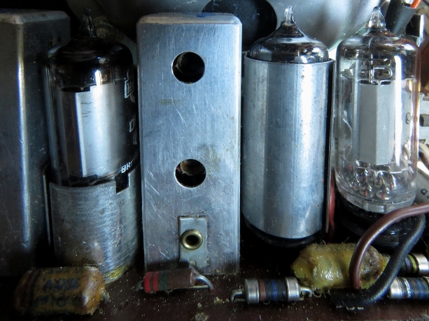

invicta: Invicta29 and all sets with DAF96, DL96
03.Aug.18 11:06
2246 von 4542
Bruce Cohen (NL)
Articles: 314
Count of Thanks: 20
Bruce Cohen
Look at mine, probaly never tempered with,
PYE P114BQ
