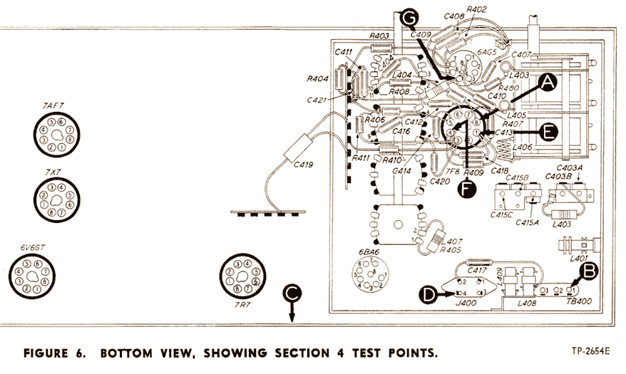

While restoring my own Philco 47-1230, I noticed that the original Philco Service Manual had errors in its part placement drawing, meant to help locating probing location for diagnostic. I was relying on this for capacitor replacement and have bad surprises...
Riders volume 19 used an exact copy of the service manuals.
I heard there are many errors in the vintage documents, to prevent problems, nothing like pointing them out.
Here's C419 how it is (erroneously) drawn in the diagnostic pages for section 4:
Parts placement as seen in the Philco service manuals, Riders, etc.
Schematics from Philco service manuals - with comments.C419 as it was in my 47-1230 before restoration (sorry but a mouse did chew on it)The pins at wich the C419 are connected are wrong. They aren't what I saw in my 47-1230, and they aren't what I see in the diagrams.  The C419 is connected from GND to R410 (and C102a), the 4th pin from the bottom of the lug strip, not L404, 3rd pin from the top of the lug strip. Note that the 3rd top and 3rd bottom are bolted to the chassis (GND)  so if it were like in the drawing, the capacitor would be between two GNDs.
here's how I think it should be drawn
corrected parts placement of C419 for Philco Service Manual, Riders, etc. section 4.
