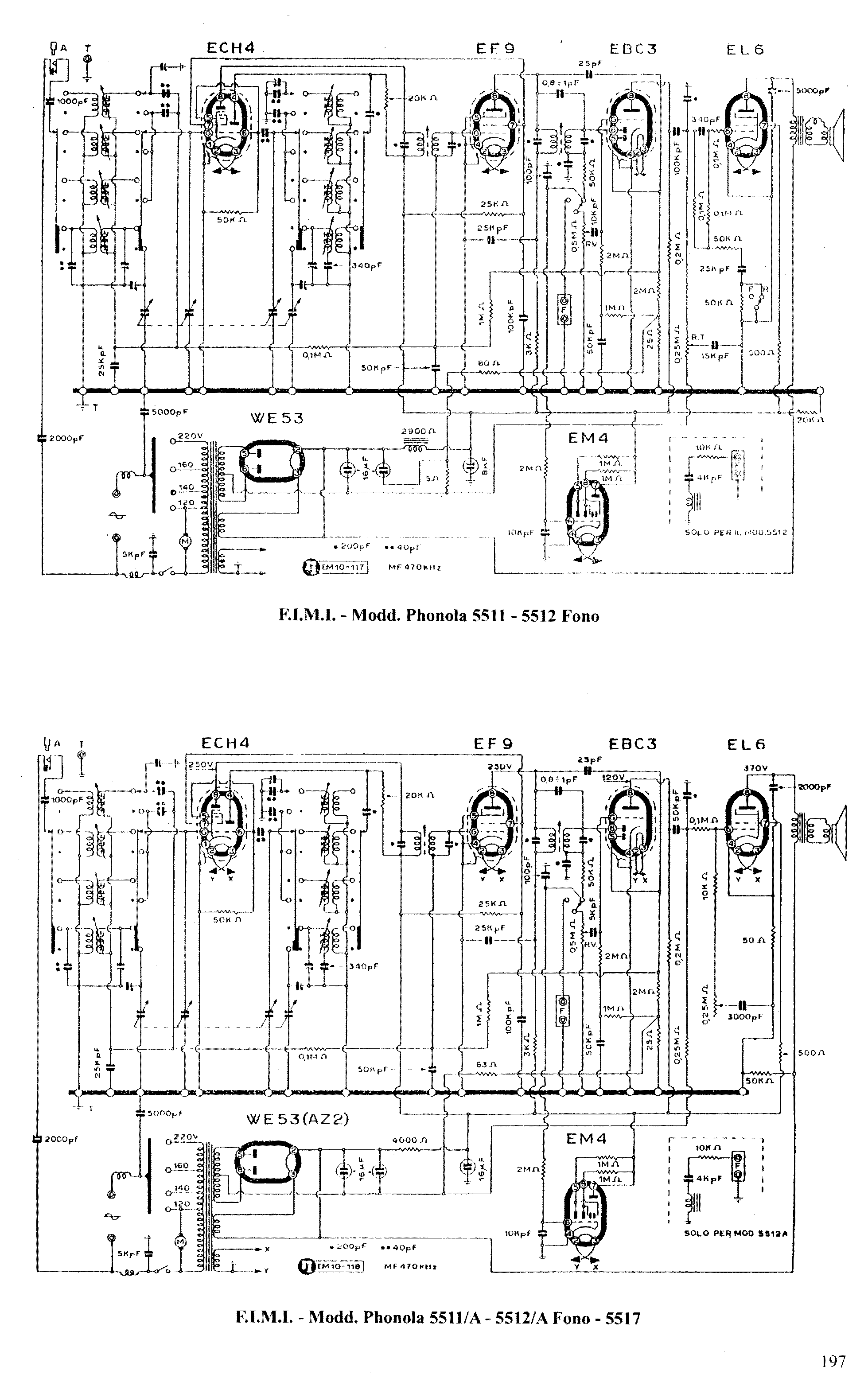

Looking at the photograph of the back of the radio, I do not think the valves you see (the Rimlock)
match those of the presented scheme (European series of tubes).
What model is reported on the label that is visible and showing the positioning of the valves?

Why would a 1952 set use  ECH4 EF9 EBC3 EL6 EM4 WE53 though which are 1930s/1940 tubes and after WWII Octal would be more likely alternative to Rimlock?
Something is in error somewhere!  But perhaps not.
I downloaded a Phonola 5512 schematic from elsewhere and it is
ECH41 EF41 EBC41 EM4 4699 AZ2
(poor quality scan but definitely that's what it is)
But curiously the EM4, 4699 (=EL6) AZ2 (=WE53) ARE the Europe side contact base P (P8A).

The answer is quite simple looking at the RMorg archives. Phonola made several updated variants of its 5512 base model, dated 1952: same shape, but updated chassis. The tube line-up in the early model included the European side contact based tubes, ECH4 EF9 EBC3 EL6 EM4 WE53.
Then we find other models:
-5512A, about 1953, tubes: ECH42 EF41 EBC41 4699 EM4 AZ2
-5512B, about 1954, tubes: ECH42 EF41 EBC41 EL6 or 4699 EM4 AZ2
-5512C, about 1953, tubes: ECH42 EF41 EBC41 4699 EM4 AZ2
-5512D, about 1953, tubes: ECH42 EF41 EBC41 4699 EM4 AZ2
Now the date of each model can be wrong, since the D should be the latest one, but the tube line-up for each model is correct.
Simply the pictures are loaded to the wrong models. The pictures loaded to the 5512 base model are related to one of the later revisions. But even the pictures loaded by Guido to the 5512A are in the wrong place, since they refer to the 5512 base model.

I am not so sure about the tubes set used in the phonola 5512A model (and 5517 chassis too) because the radio that I have (5512A Phono) uses all European lateral contacts tubes i.e. ECH4 EF9 EBC3 EL6 EM4 AZ2 (or WE53); please visit Radiomuseum for this model and see the photos that I have uploaded.
I would like point out, that the first time that the Phonola 5512 and 5512A schematics were published was in the Radiolibro 12a edition, 1951, Hoepli editor, thus the year of first production of these models could not be ascribed after that date.
Finally, there is no surprise for the presence of old tube type (obsolete) in the radios built in Italy just after the end of the Second Word War.

I am going to attach the schematic diagrams of two Phonola chassis printed from the CD 'Radio Italiane' Vol. 1, 1933 to 1953, by Mureddu and Atzeri. The material looks to be original. The first diagram covers the models 5511, 5512 and 5517. The legend on the right side also refers in brackets to a 5511A. The second one refers to 5512 A/B, 5517A and 5518. The two diagrams differ for the tube line-up, all side-contacts in the first one and mixed in the second one.
As usual, here in Italy there were a lot of models and a lot of confusion too.
BTW, I am not referring to the full ownership of Phonola by Philips, but to some kind of control that I remember since the late fifties or the very early sixties. As far as I remember, Phonola always used Philips components and even their dealers were the same.
Emilio

Dear Emilio,
What you are saying about schematics on CD is perfectly correct.
The point is (I have these CD version 2.5) that these diagrams cames from Ravalico literature (the "Radiolibro" or/and "Schemi di apparecchi Radio" both Hoepli Editor) as well most of those reported in Radiomuseum for these phonola models.
But if you look at the "Manuale del radiomeccanico" Vol. 3, page 197, G.B. Angeletti, Mosè Editor, you will find something different.

Of course, the diagram above are inverted. Unfortunately, no way to edit them and to put them in the proper sequence. The editor cannot edit the legend of attachments.

this is the usual confusion of sources here in Italy. The diagrams I attached look quite similar to Phonola original documentation. They also include in other pages the service notes and the tuning dial string layout.
This is one of the reason why I do not like Italian sets. The second one is given by the quality standards accepted for ANIE sets. The true excellence to kill users.

Let me explain my (right or wrong) thinking.
Unless the chassis is not tied to ground (I do not see in this radio a plug to be grounded), there is not reference to mains, thus no mains potential should be present at the EM4 heater.
Why the table in the schematic (please find the data reported in the second diagram , or in the attachment, for this 5567 model) show 6,3 volt at pin 1 and zero at pin 8?
Where is my mistake?
Thank you in advance, Guido.
P.S. Sorry the attachment this link is wrong.
