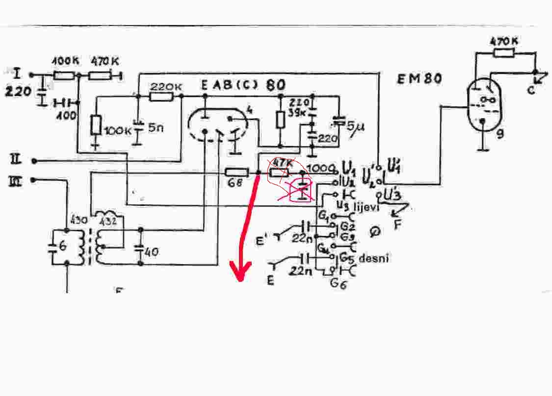

Here is a schematic diagram, red lines shows like I’ve connect a decoder.
Best regards.

I’ve forgot to mention that I was remove de-emphasis (47K resistor / 1nF capacitor), and MPX signal for chip input is taken like red line is onto diagram shown.

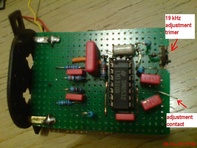

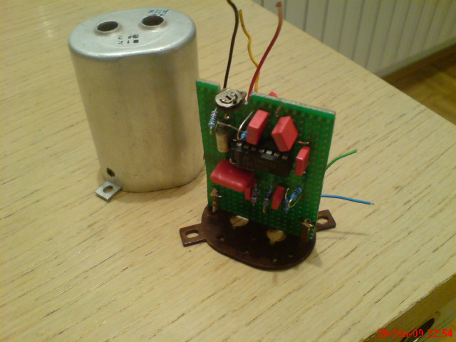

And here you can see finished decoder.
Whole construction is fitted into old IF-screening can.
There were two holes on top, one is for crocodile clamp for frequency meter, and other for adjustment trimmer.
