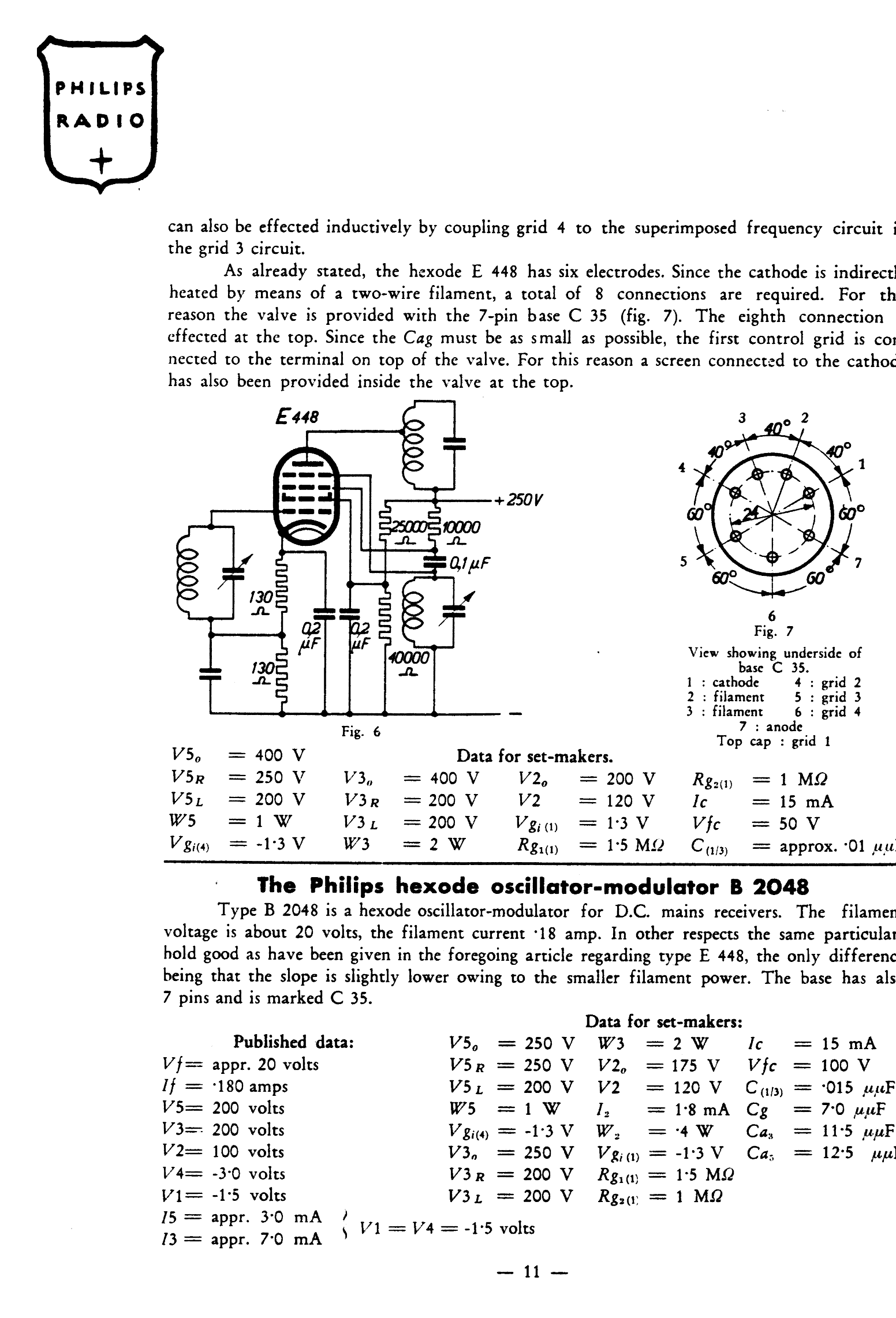

Hello Joe,
the diagram “Abb.655”, shown at the RENS1234 page, is tricky in a way: the first RENS1234 operates, as intended, as an AGC controlled hexode. However, the 2nd RENS1234 is operated in an abusive way, i.e. as hexode- oscillator - modulator, which actually should be done by the RENS1224 !
To understand the intended operation of the RENS1234 and the RENS1224, I attach some original Philips pages of the Philips equivalents to the RENS1234 and the RENS1224, the E449 and E448, repectively.
Best Regards, Jacob

Dear Jacob and Wolfgang,
Thank you for the very good information you gave.
The Philips data sheet was very useful in highlighting the different approach to gain control that Hexodes had, as opposed to the simpler pentode with remote cut-off that was favored in the USA. I always wondered what made the hexode popular in Europe.
The advantage of the Hexode as an RF/IF amplifier is that it essentially gave the equivalent AGC action of two pentodes in cascade; compare 10000:1 for an Hexode to 200:1 for a Pentode. The drawback of the Hexode vs the Pentode was inherently lower Transconductance because of the cathode current split away from the grid and into more grids with potentially higher partition noise and greater construction complexity.
Another important aspect of Hexode operation that became clear in the Philips data sheet, is that it can be quite different, depending on bias levels at G3 and G4.
Frequency converter service was described for the E448 Hexode, with G4 biased negative as oscillator control grid, and G3 serving as the non-inverting oscillator output plate. The transconductance from G3 to G4 is negative, and the voltage gain is non-inverting. The positive feedback between G3 and G4 is analogous to the positive feedback between G2 and G3 in a Transitron Pentode oscillator. G1 and G2 work conventionally as tetrode elements.
If the bias voltages of G3 and G4 are reversed, G4 becomes a positive tetrode-like screen and G3 is the second control grid. This is the recommended operation for the RENS1234 and the equivalent E449 as RF/IF amplifiers.
After my original post, I looked at the equivalent types listed in the RENS1234 page and found a plate curve for the RENS1834, which simply has a different heater voltage. This curve shows the classic tetrode kink when the plate voltage nears the voltage of the last screen grid G4. The plate is normally biased substantially more positive than G4 to avoid the gain loss at the kink.
It is now clear that G3 steers current between the G4&plate pair and G2 under the recommended bias conditions. When G3 is brought negative, more current is blocked from G4&plate and held back for G2. This accomplishes gain control action without reducing the linear input range for large signals at G1. If even more AGC is desired, then the voltage at remote cutoff G1 can also be controlled to achieve the 10000:1 control range.
