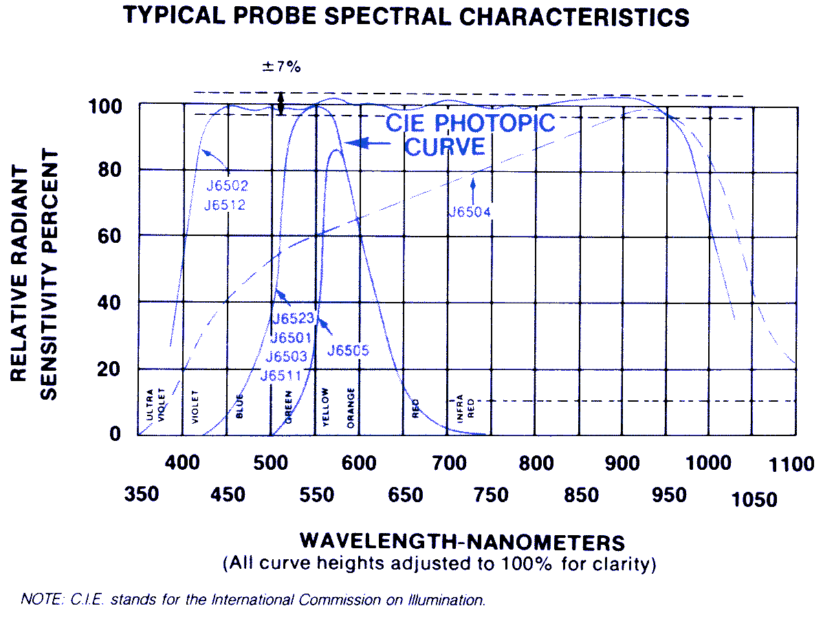

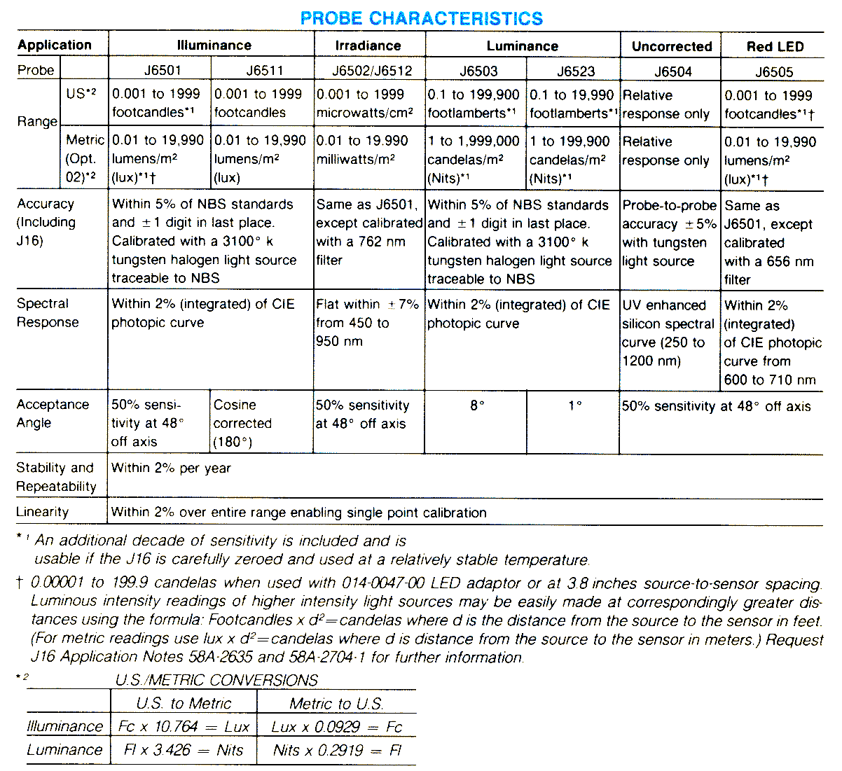

PROBE CHARACTERISTICS
for probes: J6501 J6511 J6502/J6512 J6503 J6523 J6504 J6505
Source: Tektronix Catalog 1986
