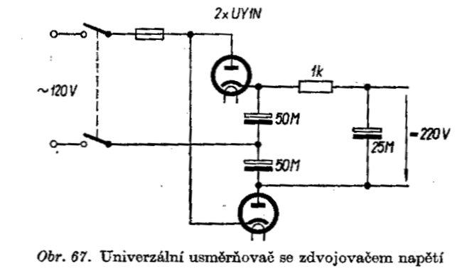

Dear Michael,
I personally never have seen schematic directly for device 414U, but might no necessary: model 414U-2 has similar electrical circuit like Tesla model 405U, except the rectifier on the input. Model 414U has diode voltage doubler on the input to be able fully work from 110V power too, something like attachment.
Gabriel
