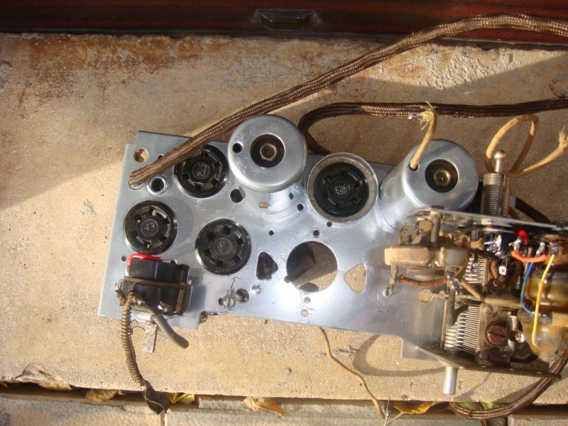

photos Zenith 702
10.Nov.10 14:59
345 de 4798
Ion Carabas (RO)
Articles: 40
Count of Thanks: 10
Ion Carabas
Dear collegues,
Please find enclosed pictures of Zenith 702.
Thank you

Zenith 702
10.Nov.10 17:36
368 de 4798
Bryan Spacek (USA)
Articles: 2
Count of Thanks: 12
Bryan Spacek
  This AC/DC set originally had a resister cord to drop the line voltage to the proper level for the filament string. The old destroyed part on the side of your set is (was) a candohm resister, that was probably part of an earlier attempt to do away with the resister cord so that a modern type input cord could be used.
It is pretty common to run into this with these older sets with resister cords. They can be quite dangerous (fire hazard) with the higher voltages we use today. They were built for 110 volts, but usually today you will get 120 volts and up to 130V. That's too much for those old cords, and they will over heat.
 The large gold resister seems to be a replacement for the destroyed candohm resister. It appears to be between the on/off switch and the filament string. The purpose would be to drop line voltage in place of the resister cord.
  If you could check the line cord for it's resistance value, that should verify this theory. If it has little to no resistance, then we are on the right track. If it is 145 ohms, then the old resister cord is still in place, and we need to go another direction.

702
12.Nov.10 10:50
491 de 4798
Articles: 2316
Count of Thanks: 13
The element in question contains two resistors of 75oo Ohm and 250 Ohm resp., and a capacitor of 0.05 µFas follows:
A - B = 7500 Ohm
B - C = 0.05 µF, in parallel a 10 kOhm resistor E
C - D = 250 Ohm (schematic says 200 Ohm).
Point D is chassis
Note: the cap is not directly connected with chassis ground, as suggested by the schematics!
Here is the configuration as found in my 702 (compare with the "official" schematic):
